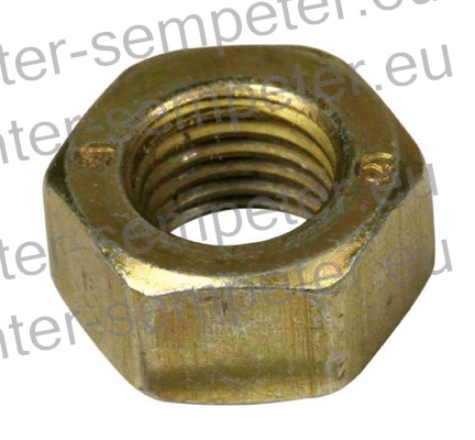

Matica kojom se sarafi truba (kuciste poluosovine), na centralno kuciste, na IMT539, izgleda nije standardna kakva se moze kupit u zeljezari. Probao sam oprezno, standardne matice M12, i ne odgovara. Uglavnom razlika je vidljiva u zadnjoj recenici onoga sta je gore pejstano.
"1,5 (or 1.5): This indicates a fine thread pitch of 1.5 millimeters. A standard M12 thread would typically have a 1.75mm pitch."
M12x1.5 vs M12x1.75
refers to metric bolts with the same 12mm diameter but different thread pitches: M12x1.5 is a finer thread (closer threads), while M12x1.75 is a coarser (standard) thread with more space between threads, meaning they are not interchangeable and will not fit each other without damaging threads.
Key Differences Explained
M12: Both fasteners have a 12mm nominal (major) diameter, the width of the bolt's shank.
Pitch (x1.5 vs. x1.75): This number is the distance between adjacent thread crests, measured in millimeters.
M12x1.5 (Fine Thread): Threads are closer together (1.5mm apart).
M12x1.75 (Coarse/Standard Thread): Threads are farther apart (1.75mm apart).
Why They Don't Mix
Using the wrong pitch will cause problems:
M12x1.75 into M12x1.5 hole: The coarser threads will try to cut into the finer threads, stripping them and ruining the fastener or the threaded hole (like an oil pan).
M12x1.5 into M12x1.75 hole: The fine threads won't properly engage the coarser threads, leading to a weak, unreliable connection, or it might not even start.
In essence, think of it like trying to fit a wide-toothed comb into a very fine-toothed comb's slot – they don't match up correctly
To matica je izgleda na linkovima dolje dostupna, ali to su izgleda u Sloveniji trgovine.
Ta matica ide na ovaj brezon.
Budem nazvao u Jozic, ako imaju brezon, mozda imaju i maticu za njega u ponudi.
Nasao sam i ovo, budem probao prvo to, na prvu moglo bi odgovarat jer je M12x1,5 specifikacija.
Ali izgleda da je ovo bas odgovarajuca matica, sta mi treba.
Eto, mozda nekom drugom pomogne.
